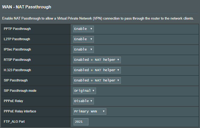

    Issues:
    LAN speed is limit at 200mbps, but my WiFi speed can go up to 100% at 500mbps.
    There's no NAT Acceleration setting, but HW acceleration shows:
    Runner: Enabled - Flow Cache: Enabled
    [​IMG]
    QoS Settings:
    QoS Type: **Adaptive**
    Queue Discipline: **sfq**
    LAN-Switch Control:
    Jumbo Frame: **Disable**
    Spanning Tree Protocol: **Disable**
    [​IMG]

    Disable QoS completely and test again. How are you testing the speed?

    I tried disabling QoS completely but the speed is the same. 100~200mbps (speedtest.net)
    My actual ISP bandwidth is 500mbps.
